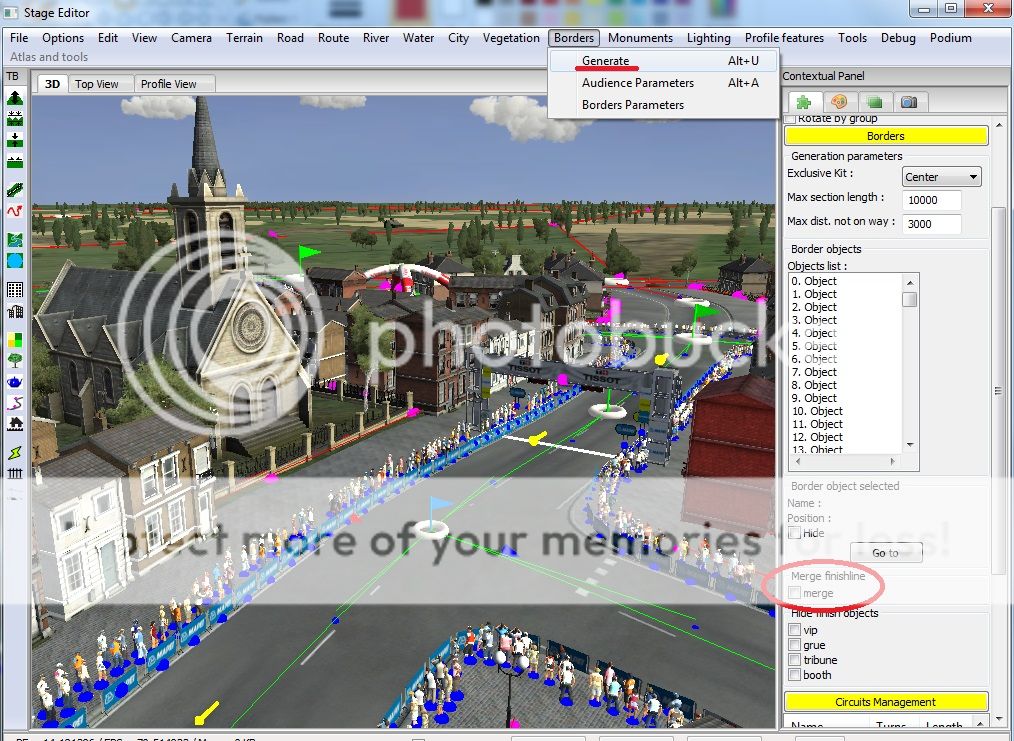

I got a fast simple question (I think)
I haven´t ventured into full stage creating, only trying to fix minor problems when I get the benefit of a zcts file.
My question is that on several stages the irritating issue of having the riders to race through the spectator stands close to the finish line.
Can this Stand be DELETED from the finish, since it´s sometimes even blocks the entire road, OR is this something that is just added in-game close to all business ends of races.
Give me a hint if you got what I mean ....
ricardo123
uncheck merge finish line -> Borders -> Borders Parameters
i1349.photobucket.com/albums/p754/steven32737/ritten2_zps2c36867b.png

Margh Norway
Second what ricardo wrote.
Once posted you this pic:
img109.imageshack.us/img109/7782/x7h7.jpg
clamel
Thanks mates
I give this a try, when additional XML stuff is ready. (That´s 2.1 and 2.2 races)
So that was the picture Margh ( I remember, but didn´t understand, sorry slow mind)
Margh Norway
clamel wrote:
Thanks mates
When the issue you discribed looks somewhat like this...
i1056.photobucket.com/albums/t361/MarghNorway/editor1_zpsd11f8780.jpg
...goto
(red underlined and circled)
After unticking it should look like this:
i1056.photobucket.com/albums/t361/MarghNorway/editor2_zps9f707e9e.jpg
(klick "generate" after unchecking to see if it worked)
The proplem appears with unconverted 2012 stages or (in rare cases) when the stagemaker forgot to uncheck "merge finishline" when it's needed.
