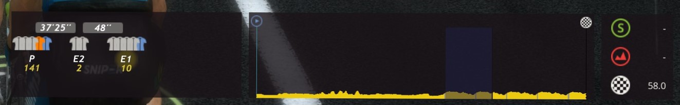

Just look at the time gap. At the finish it was over 50mins. 1 day race too. So what is up with the AI?
Elton attached the following image:
bah

Did you manually install stage variants?

I used the pcm.daily lite pack and pretty much assume that I dont have to do much else than install it as it is.

I dont think it's on the lite pack then, that one doesn't add any stage

Is that a NC race? The AI is wierd sometimes in the NC races. Has nothing to do with DB's, it's about the coding of the game and ai.

Its Le Samyn.

I remember a similar bug in the Portugal original NC stage in PCM 16, some stages of Cyanide have that issue.
This happen because the peloton AI rides at very, very low speed (of course bug). What you can do is get a different variant of that race, or simply simulate.

I was in the group of the winner in a belgian championship where we finished 48' in front of the peloton. We had more than 50' at one point Grin

It still happens, though not by such ludicrous margins. The break almost always wins by a few minutes unless you pull yourself.
I don't think as much an AI issue as it is pure lack of manpower, a 40 men peloton with one one or two teams with more than one rider.

I'm in my 10th season, max gap for a breakaway has been 10-15 min. Maybe your career is bugged or something

Reinstalled the game and reinstalled the daily lite pack.
Same race but this time it worked normally. Just 2 in the breakaway and got caught with about 20kms to go. Maybe its trial and error on all races, meaning that you may have to replay them to get a more realistic result.

I reported this some time ago about this stage in the proper thread https://pcmdaily.c...rowstart=0
about c1_kampvlaanderen_2015(which is really c1_fayt_2013)) ,same as "samyn" ;look at the cdx file ,it's the same map.

Hopefully its just the map that has a bug and not the ai. But i've had a problem where breakaways consistently succeeded.
