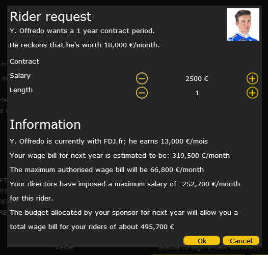

I used the editor to lower wages and change the contract end of my riders. I know have about 120k budget space to sign a few more riders (indicated in the contract offer screen).
However, I can't change the contract offer itself. It seems like the game still thinks I'm over my budget.
Thanks already for your help. |

DrBeer attached the following image:
Edited by DrBeer on 14-09-2014 20:03
| matt17br |
Posted on 14-09-2014 20:14
Directeur Sportif
Posts: 10519
Joined: 28-09-2013
DrBeer wrote:
Space did it.
It is because you already reached your salary cap. You can lower your riders contracts with lachis editor. In order to do this go in dyn_contract and edit your riders wages.

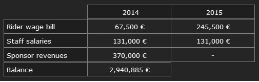

Here's a printscreen of my wages. These are lowered, so it's weird that it would be capped for 2014.
When you look at the screenshot above, it shows I have about 270k salary space left for 2015 as well.
| Lachi |
Posted on 15-09-2014 09:00
Posts: 8360
Joined: 29-06-2007
Your problem is the third line: The max. authorised wage bill will be 66,800€/month.
Did you try to raise the contracts of your riders to increase the cap?
In previous games, I was able to raise the salary cap by raising the contracts which were ending at the end of the season.
(Of course you should also change back the contracts which you had lowered before, so the easiest solution would be to start all over with your editing by using the backup you made before you started your editing.)
