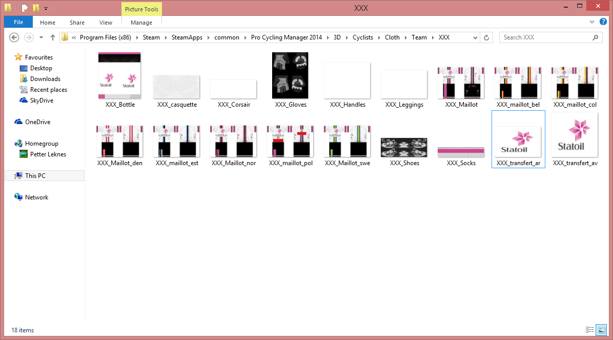

I tried making the national jerseys the same way you showed with your photo, but in game the only change was to the jersey and not to the pants, could this be because I use a custom database as well and edited one of the new team that came with that database? Im using the FDB14 database and the XXX team and when i added the national champion shirts there for instance xxx_maillot_est they didn't show up and I had to add them to the standard folder for the national jerseys but then only the shirt shows and not the pants.

The way you describe it (xxx_maillot_est), the national kit should show up normally. You don't have to change the database for that. Why it doesn't show up can have many causes, like wrong name, file format, file dimensions etc. From here I cannot tell you what is wrong. Could you maybe make and upload a screenshot of the team folder (where the xxx_maillot files are)? Then we might be able to help you.

Here is how the files look, the files are png files and 910x626 in size
fra leasy attached the following image:
Deksel
I cannot spot any mistake, so normally this should be working fine. Maybe the guys who developed the FDB14 can help you with this. This is the topic for the FDB14 (for PCM14): https://pcmdaily.c...rowstart=0

Make sure the PNG is not compressed or interlaced. The game doesn't read compressed or interlaced files.
