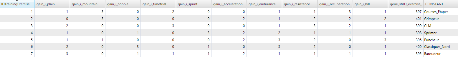

Each training type improves several stats, I have attached a screenshot from Lachi's editor. Note you cannot train downhill, that will improve with time, but ever so slowly, many riders never reach their potential.
Ripley attached the following image:
