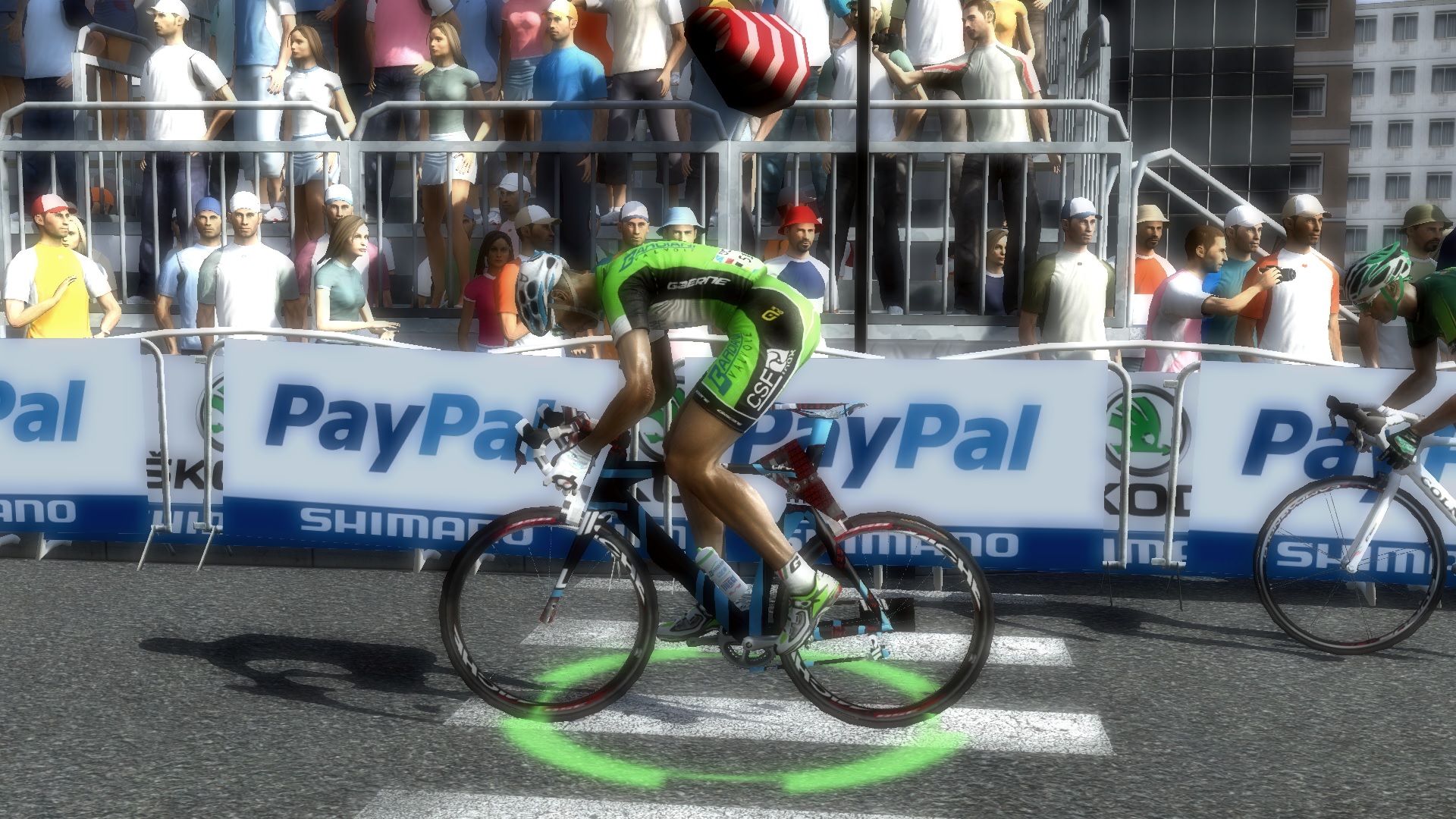

I used to have 2 Cipollini frames. But both aren't working properly ingame now.
It looks like the picture below...
Can anyone help me/upload me a working Cipo frame?
timpiej attached the following image:
sgdanny
Please upload the files from 3D/Cyclist/Equipment/Frames with the files starting with frame_Cipollini
i.imgur.com/pyvc2uc.png
timpiej
Here are the 3 (2 RR, 1 TT) frames. Iirc also the TT frame doesn't work.

Good news is that I've found the problems and the bad thing is that I will need your career database to corect the problem. You can find it in Documents/Game Folder/Users/Username/Database/Solo/Name of the save.
The second RR frame is having an wrong _N file, which decides which part of the _D file are placed on the frame. Also the _S file is using an overlay and should be deleted. Reason I need your db, is because the abbreviation should be frame_cipollini_02_D instead of frame_cipollini2_D for example.
Meanwhile all _N files you've uploaded are in fact made wrong, it can't decide where to put the graphics in the _D file. I will need your db and then I can send you the fixed db with the right files for the frames Wink
KenL
The _n.dds file has nothing to do with the graphic problem you are demonstrating. The n file only adds shadow and light glow to the frames.
the _s file is for auto-colouring, anything solid on this file will put your teams database colour over the _d file ingame.
Your problem is likely that you are using the wrong nif file for that particular _d file.
I checked the files that were sent you and indeed the frame_cipollini2_d file is for a Cyanide designed frame nif while the frame_cipollini2.nif is also for the frame_cipollini_d frame. nif. Works perfectly if you match the cipollini2_d file with the cipollini.nif.
You are missing the Cyanide nif, or you work from the cipollini nifs that were both designed by bikefreak, I believe.
Edited by KenL on 02-04-2015 14:01

KenL
I have reworked your files so that they all link to there correct nif.
Cipollini: I have renamed to Cipollini1 and is the nif made by bikefreak;
Cipollini2: is the messed up _d to nif, it is now the Oleg Tinkov _d file version with the correct Cyanide nif; and
Cipollini_tt: is just linked correctly to the nif, also made by bikefreak.
For each frame, I created a new and corresponding _n file and gave each frame an _s file that is transparent, (So Auto-Colouring is not enabled).
Link: https://www.media...9wlyx01ch1
Edited by KenL on 02-04-2015 14:34

timpiej
Im checking the frames as we speak, they look such better now
Edited by timpiej on 03-04-2015 19:30
timpiej
Thanks zlot KenL !!!
timpiej
Thanks alot KenL !!!
